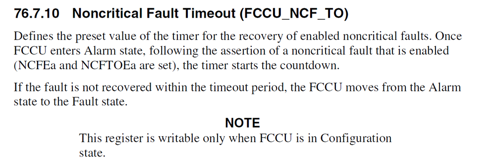

petervlna
by default there is some reset value in TO register. (for my MPC5748G it is 0x6)
When you need to set timeout, set it shorted then FOSU watchdog. Otherwise your alarm state with active fault and FOSU watchdog expire will be reset by FOSU destructive reset.
Peter
3,352 Views
petervlna
Well you didn't share much information with us.

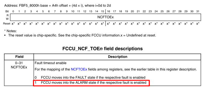

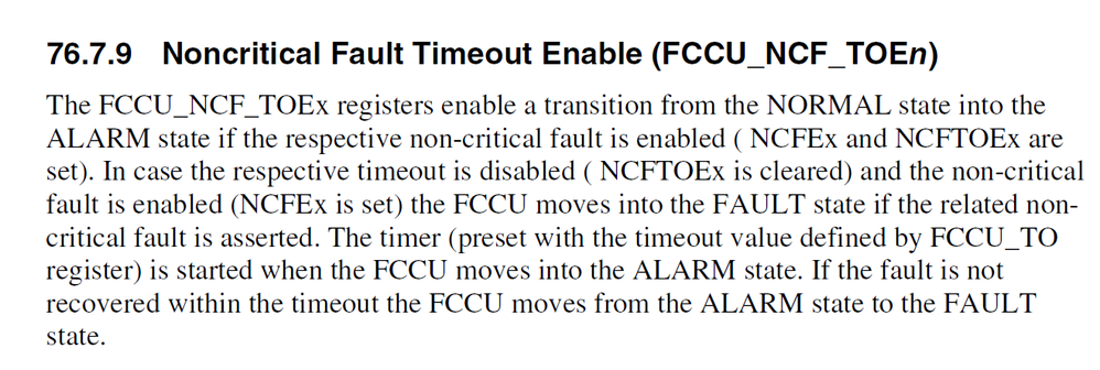

TO register:
Defines the preset value of the timer for the recovery of enabled noncritical faults. Once FCCU enters Alarm state, following the assertion of a noncritical fault that is enabled (NCFEa and NCFTOEa are set), the timer starts the countdown. If the fault is not recovered within the timeout period, the FCCU moves from the Alarm state to the Fault state.
1. Do you have your fault enabled in NCFE register?
2. Do you have alarm state enabled?
Noncritical Fault Timeout Enable (FCCU_NCF_TOEn)
Peter
