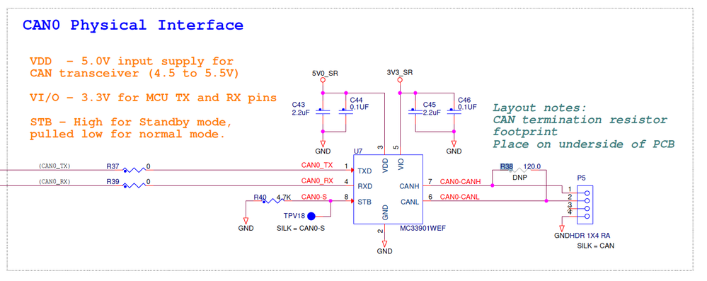

I am trying to test the FlexCAN module using the S32 SDK 0.9.0 BETA for the MPC5744P. I have tried loading the example code, which on reception of a CAN message toggles the DEVKIT LEDs and also sends CAN messages when the switches are pressed. I am using a Vector VN1610 CAN-to-USB to communicate with the board when running, however, I seem to not be able to receive or send data to the board this way. On debug, I see that the program is stuck in the loop
while (FLEXCAN_DRV_GetTransferStatus(INST_CANCOM1, RX_MAILBOX) == STATUS_BUSY) { }
I have also monitored the signals from the CAN ports on the DEVKIT as well as the Vector VN1610 and I can read signals on the scope so I am unsure why the the transfer status cannot 'finish' i.e. the loop is infinite.
i have attached my set-up as well as the tests I have made on the oscilloscope.

I'd recommend to add terminating resistor 120 ohm between CAN_H and  CAN_L terminals or populate SMD resistor 120 Ohm - R38 pads
pastedImage_1.pngAlso please make sure you setup the CAN bus correctly on the PC side:
500kbps, 85% sampling point
Hope it helps.

If you don't use the S32 SDK I think you can just replace CAN2 with CAN0 in the example code you saw, but you probably need to pay attention to the peripheral clocking for CAN0. On the DEVKIT, only CAN0 is connected to a proper CAN transceiver (MC33901WEF, see above) so with minimal set-up you would just need a 120-ohm resistor and some wires to connect to the Vector CAN peripherals.

I do have an additional follow-up question, however. Are the values 500kbps and 85% sampling point dependent on the CAN transceiver (MC33901WEF) in the case of the DEVKIT? Also, the default sampling point was 87.5% actually, which worked.
11,074 Views
chuluezhong
Thanks very much, I now have the example code working. I thought initially that this resistor was already on the board.
