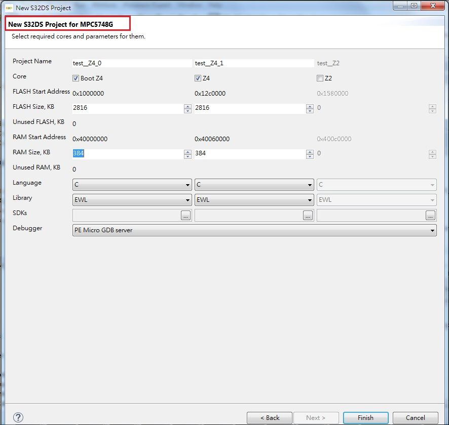

Creating a S32 flexuart example project, LINFLEXD_UART_DRV_XXX() functions are working well.
When creating a new S32 project, then porting flexuart function.
Then modify main() for UART communication based on LINFlex I/F.
main()
CLOCK_SYS_Init(g_clockManConfigsArr, CLOCK_MANAGER_CONFIG_CNT, g_clockManCallbacksArr, CLOCK_MANAGER_CALLBACK_CNT);
CLOCK_SYS_UpdateConfiguration(0U, CLOCK_MANAGER_POLICY_FORCIBLE);
PINS_DRV_Init(NUM_OF_CONFIGURED_PINS, g_pin_mux_InitConfigArr);
//Simply add couple lines to configure LINFlexD_10 for UART communicaiton
LINFLEXD_UART_DRV_Init(INST_LINFLEXD_UART10, &linflexd_uart10_State, &linflexd_uart10_InitConfig0);
while(1)
LINFLEXD_UART_DRV_SendData(INST_LINFLEXD_UART10, (uint8_t*)msg, strlen(msg)); //No response from console at all
The example code as attachment "test_flexcan_uart.zip"
Anyone knows what problem about S32 DS?
Thanks in advance.

It seems clock source and INST_LINFLEXD_UART10 are the problem, because I created another project by "New\S32DS Project from Example\linflex_uart_mpc5748g", and its UART works.
I use the same pinmux/clock source/INST_LINFLEXD_UART10 with both of projects.
The project as attachment "linflexd_uart_mpc5748g.zip"
Maybe there is something wrong with my S32DS environment..>.<..

After comparing the generated Processor Expert Code, I can see that there are a number of changes which need to be made inside Processor Expert.
In Clock Manager
In LINFlexD/UART
In Pin Mux
I also noticed you are using the S32 SDK MPC574xx EAR 0.8.1, I would recommend that you install the update ( S32 Design Studio for Power Architecture 2017.R1 - Updates 5 and 6 available) and use the latest S32 SDK MPC574xx RTM 1.0.0

It is still not working after modified clock source & INST_LINFLEXD_UART10.
When I try to do "Install new software" with S32DS_PA_v2017.R1_UP5_UP6.zip in S32DS.
System stuck here.
Thanks for reply.

When update process stuck again, just leave it overnight, then I saw it finished this morning.
I created a new project based on S32 Design Studio MPC574xx SDK RTM 1.0.0.
Now FLEXCAN_DRV_xxx()s are working well, message come out from UART success.
