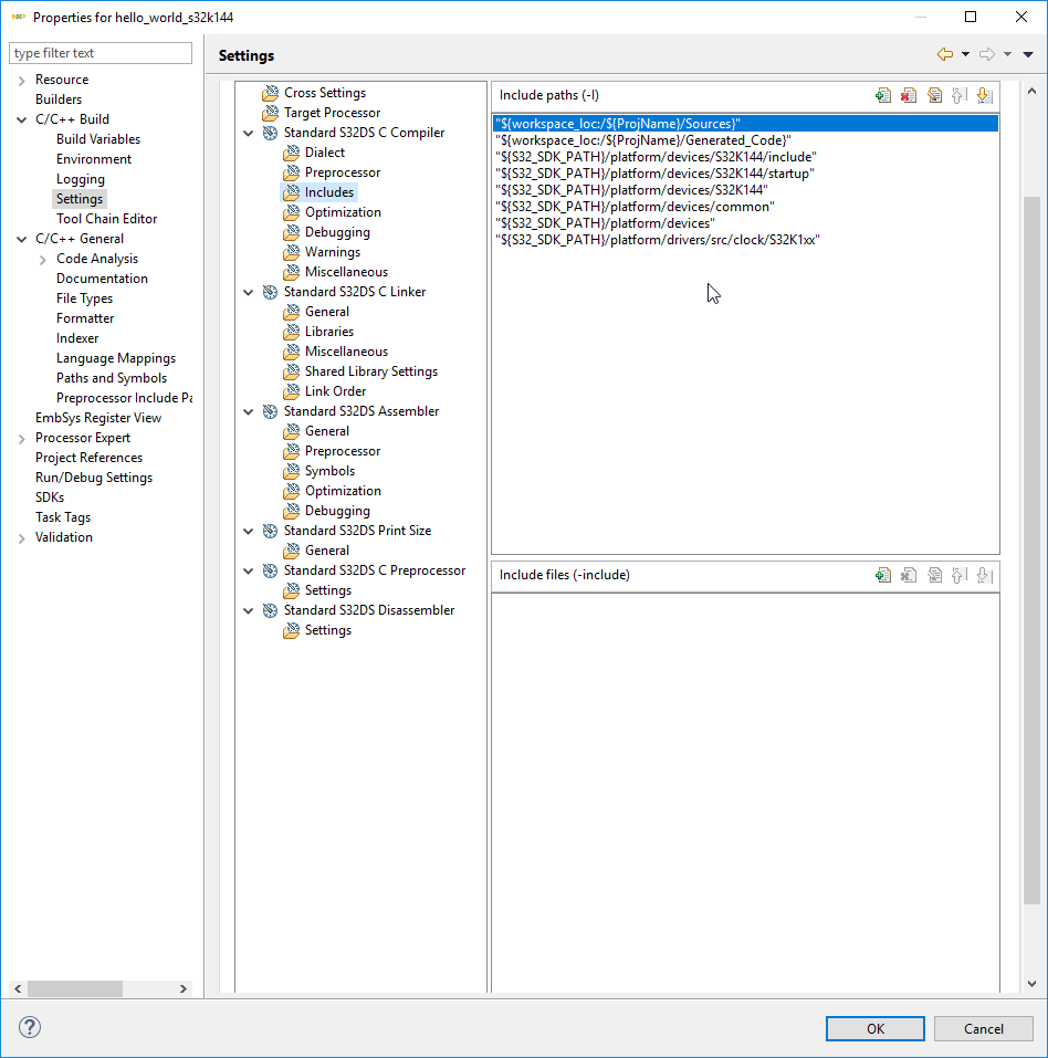

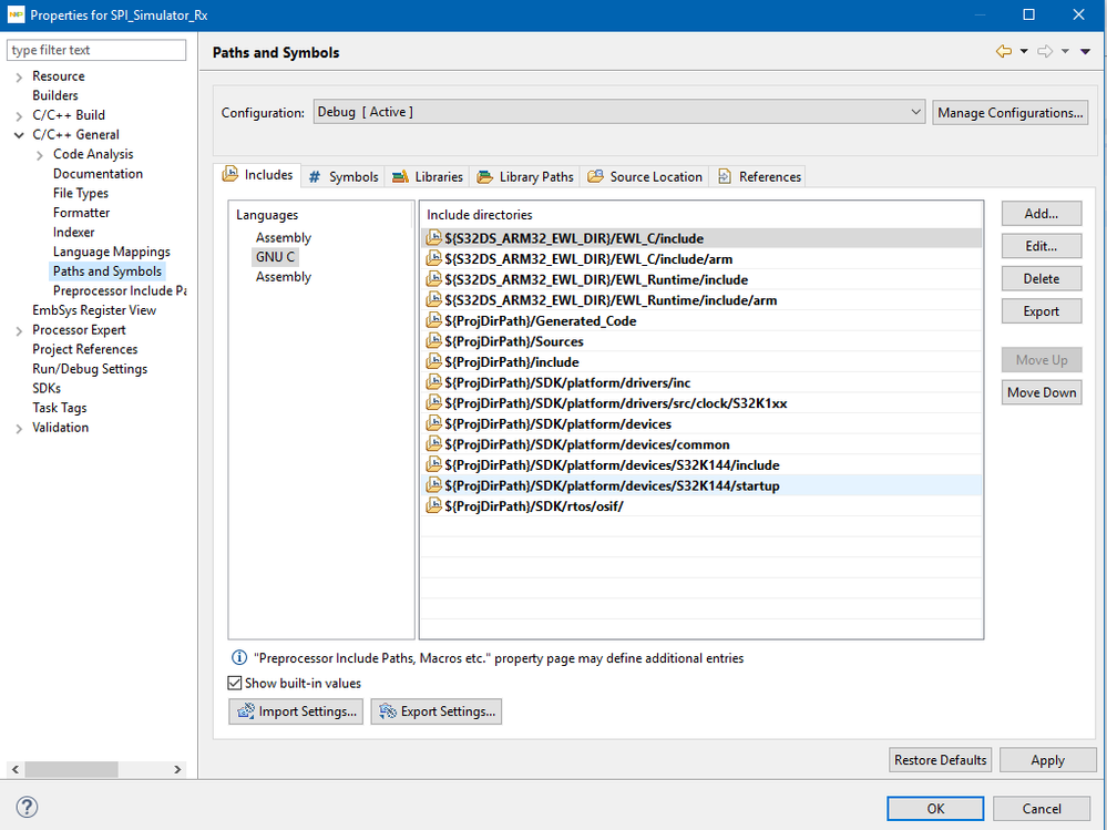

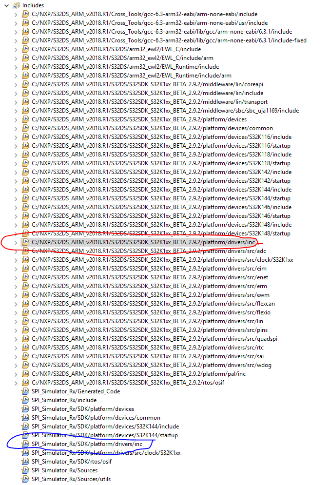

I have adopted some of the SDK drivers in my local project code including a header file / typedef. I'm now facing the problem that the compiler includes all the headers from SDK source directory and I could not manage to change this.
behaviour:
- including from red is not wanted (SDK source)
- include from blue is wanted (my local header file)
Project Settings:
Thx
W.

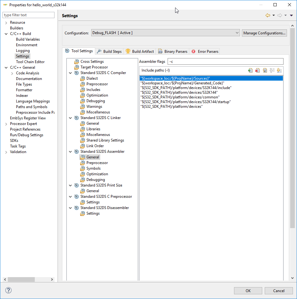

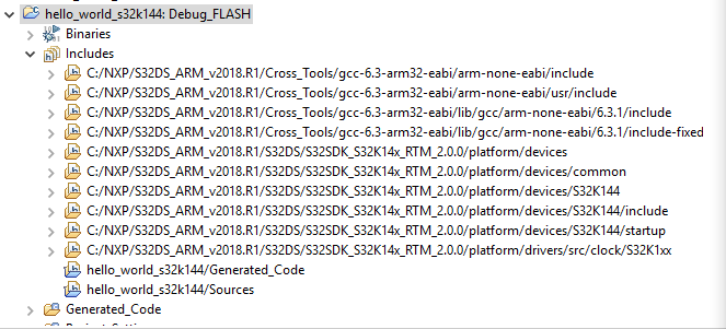

For me works removing include paths from project properties. You need to remove it from C and assembly:
In this case - ....platform/drivers/inc path disappear from Include list:
Hope it helps.

For me it does NOT work! I had already removed the pathes for C and assembly. I checked again, but for me it does not work. There must be some other source or setting for including theses files.

Q_man
Hi Satish,
yes the problem is fixed!
Not sure what the original root cause was. Fixed by manual editing the .cproject file.
