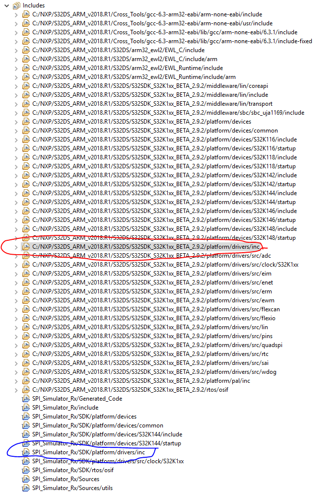

I have adopted some of the SDK drivers in my local project code including a header file / typedef. I'm now facing the problem that the compiler includes all the headers from SDK source directory and I could not manage to change this.
behaviour:
- including from red is not wanted (SDK source)
- include from blue is wanted (my local header file)

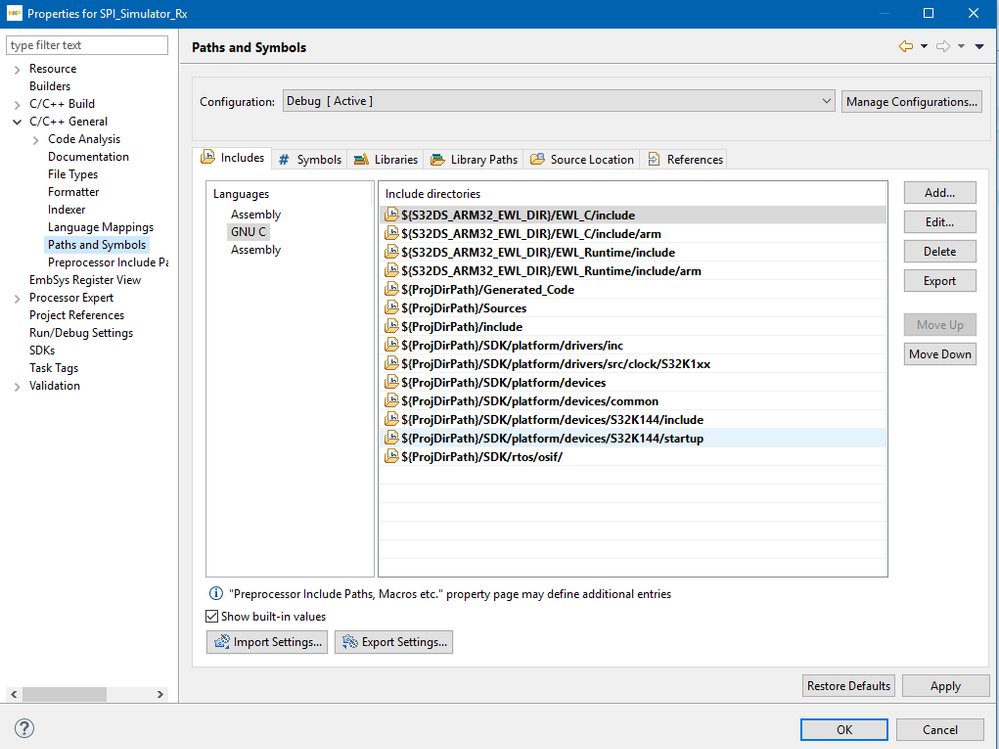

Project Settings:

For me works removing include paths from project properties. You need to remove it from C and assembly:
In this case - ....platform/drivers/inc path disappear from Include list:

Hi Jiri,
thanks for your reply.
For me it does NOT work! I had already removed the pathes for C and assembly. I checked again, but for me it does not work. There must be some other source or setting for including theses files.

yes the problem is fixed!
Not sure what the original root cause was. Fixed by manual editing the .cproject file.
