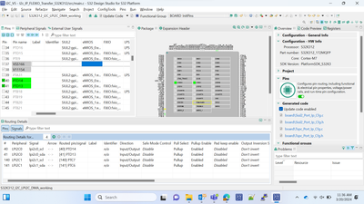

I am an faciing an issue with I2C code using DMA. I've attached the code below.
I am facing difficulties receiving the transmitted value in the receive buffer slave.
Upon probing with a CRO, we observed that the SCL clock is not reflecting.
Pins used
Additionally, we have debugged the lpuart_i2c code and flexio_i2c code available in the 2.0.1 package, but even with these, we aren't getting any SCL clock.
how can we resolve this?

JIBIN_7
its working after connecting 4k resistor externally.

@Julián_AragónM What is the pin connection or hardware connection we do in S32K312 Eval board? As of now I am connecting I2C0 pins to I2C1 pins. SCL (PTD14 to PTC7) and SDA (PTD13 to PTC6). As for this example I need to see data in the rxBufferSlave should be populated with the values same as the txBuffer but it is always showing zeros in the rxBufferSlave. Any inputs for this? Should we have to make any hardware changes like connecting a pull-up resistor additionally.
6,889件の閲覧回数
Julián_AragónM
Hi @SandyHCL
The connections you mentioned are correct. LPI2C0 - LPI2C1:
  • [40] PTD14 lpi2c0_scl - [140] PTC7 - lpi2c1_scl
  • [41] PTD13 lpi2c0_sda - [141] PTC6 lpi2c1_sda
The rxBufferSlave should be populated with the values.
No additional hardware modifications are needed. If the example is still not working, please confirm the jumper configuration is the same as the Getting Started with the S32K312EVB-Q172 Evaluation Board for General Purpose
