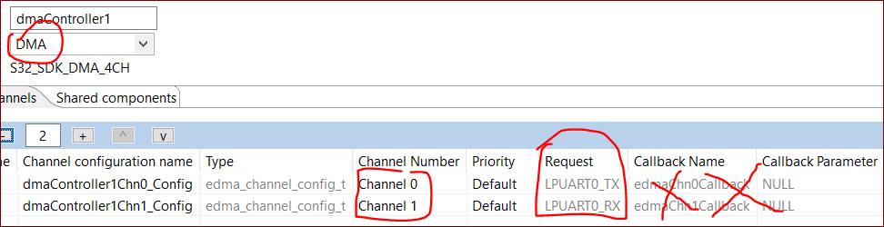

Dear All,
I want to ask a question : eDMA receive UART data. But I can't found the UART reveive end Interrupt.
I want to send a respionse UARTdata immediately after receive UART end edge.
Where is the eDMA receive end ISR?

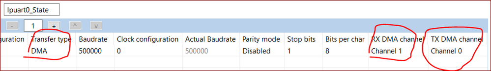

LPUART configuration :
DMA configuration : (DMA Callback is not configure, can' t change name,)

Hi dearwww2000,
I modified the SDK echo example to work with DMA.
The example is attached, please try it.
