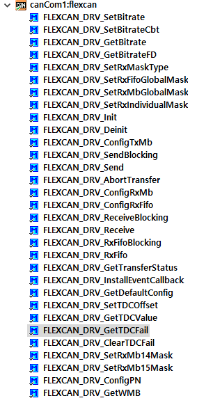

I use S32DS for ARM.2018.R1 and SDK EAR 0.8.6.
On FlexCAN, How to get CAN error state (CAN BUS OFF)?
I can't find the function to get CAN error state.

sure - there is interrupt specially for Bus Off - CAN0_ORed_IRQHandler and for other errors you can implement
CAN0_Error_IRQHandler.
You can install your handler by INT_SYS_InstallHandler();
More details about CAN interrupts you can find on Chapter 53.1.4 FlexCAN Interrupts (S32K1xx Series Reference Manual, Rev. 7, 04/2018 - page 1630).  SDK example lpit_periodic_interrupt_s32k144 is good example how to add custom interrupt handler.
Hope it helps.
Jiri
4,645 Views
jiri_kral
it looks like that this feature is not implemented in SDK. You can get this info from register directly:
CAN0->ESR1 & CAN_ESR1_FLTCONF_MASK
Jiri
