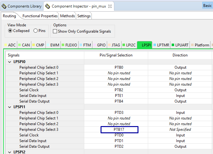

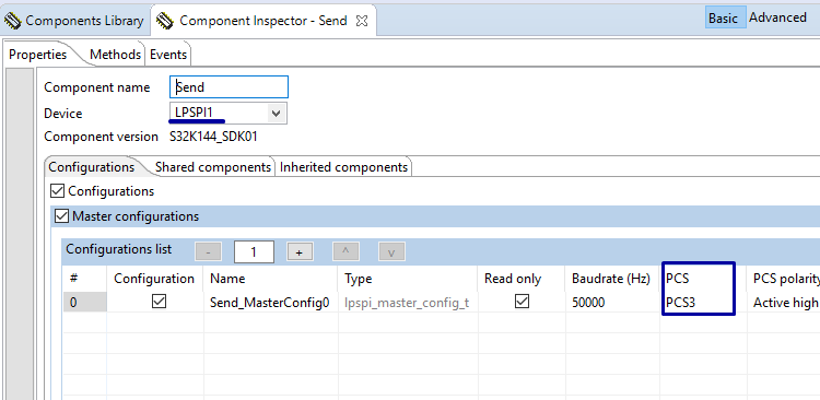

I use S32K144 EVB, S32DS for ARM and SDK EAR 0.8.6.
I want to use PTB17 as SPI Chip select PIN.
But It does not work.
Can I use PTB17?
If I can use PTB17, How to use PTB17 as chip select PIN?

danielmartynek
Did you select the following?

kbj
Dear Danial,
Thanks for your help.
