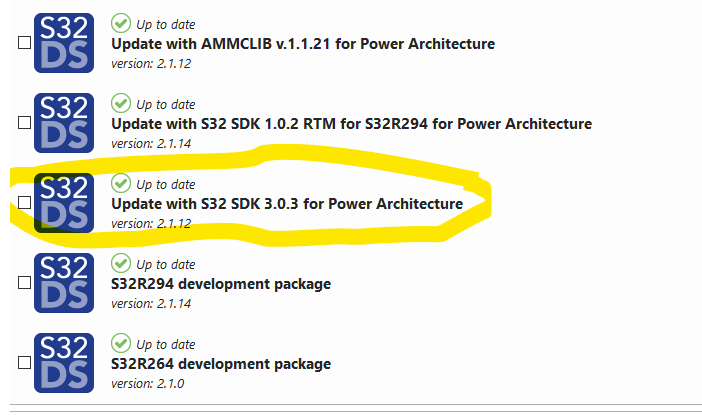

3,155件の閲覧回数
rjoycequincy
 I hope these are the details you are looking for .
Please note I am developing for MPC5748G only.
I am not sure how or when the   S32R274 and S32R372   packages  were installed,
and I think I need  only care about the  3.0.3 SDK    (S32 for Power Architecture). .
I inherited a previous installation and I do not know how to remove the other SDK's.
These may be redundant to the 'Installation Details': The list is long so the image capture is in two parts.
3,168件の閲覧回数
DanNguyenDuy
Hi @rjoycequincy,
what is the package you are using?
Dan
