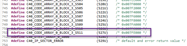

I am trying to use an embedded flash sector to store and retrieve configuration data. Using a S32K3x4EVB-Q172 initially I tried to use the C40_Ip driver to read and write the last code sector C40_CODE_ARRAY_0_BLOCK_3_S511, sector 527 at address 0x007FE000. However when attempt to access even read this block I see a hard fault. Switching to using the C40_CODE_ARRAY_0_BLOCK_2_S256 I can seem to read the data on occasion but get random hard faults, particularly from cold start, or if I attempt to erase and write. As these blocks are not used by the running code why do these hard faults occur?

Thank you for getting back to me. From trial and error I managed find that C40_CODE_ARRAY_0_BLOCK_3_S500 worked for me so have been using that. Thanks to you I now understand why.

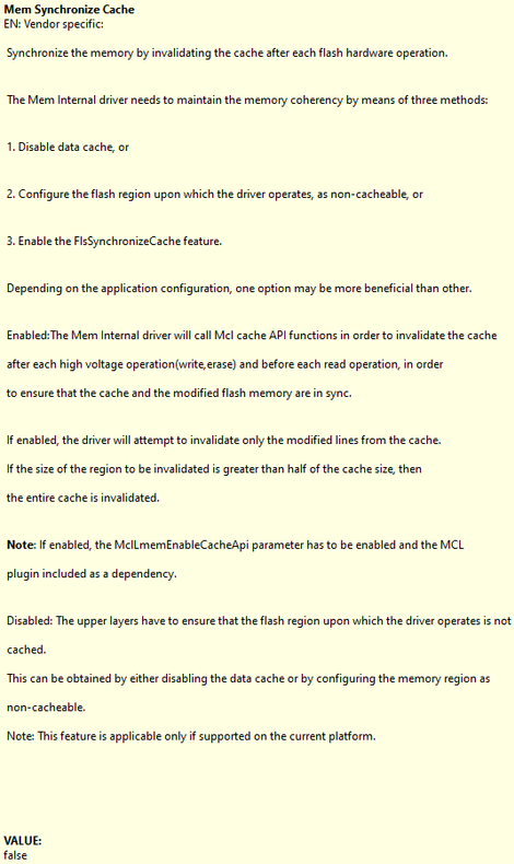

The hard exceptions seemed related to cache data flushes, which I did not investigate thoroughly. I found that if I disabled the C40_Ip driver option Mem Synchronize Cache the issue went away, although it did raise a concern over data integrity. Is this an acceptable approach or should I go back and look more closely at the exception?

The cache invalidation is application-dependent.
