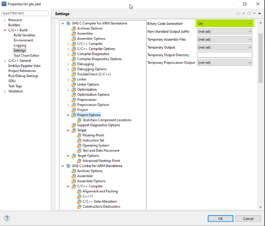

I want to generate raw binary when build using Green Hills Software compiler in S32 DS
but I can't find the setting to generate binary file.
Could you please let me know for this.

You can enable the bin generation option.
