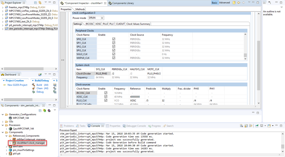

   My IDE is S32DS and create an example project from stm_periodic_interrupt,then i add one component PIT and enable it's "Enable Standard timers",the PE prompt me:"Please configure the PIT clock source by clock manager!"
   But i can't find where i can config it.please help.

When i enable a "Enable Standard timers" in the PIT config framework,ide prompt me the message.
3,487 Views
martin_kovar

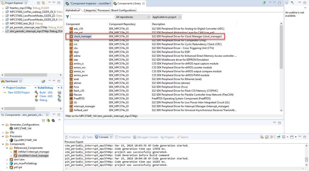

it is a bug in the example. Please remove the clock manager component from example and insert it once again.
Now it will work correct. I will also report this bug into our defect system.
