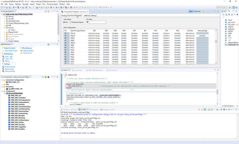

am working with the MPC5748G DevKit and the S32 SDK.
In the "Component Inspector" (pin_mux:PinSettings) i'm able to set the GPIO's Input/Output (SIUL2 Mask)
The Pin component (pin_mux:PinSettings) is offering me some functions which i can drag'n drop into my code.
Now i want to set a GPIO resistor pull-down or no-pull, active high or active low.
Are there functions for GPIO settings? I can only find functions which handle Ports, like PINS_DRV_SetPullSel().
Or do I have to config the GPIO directly like SIUL2->GPDO[x] = SIUL2_GPDO_xxxxx
Thanks for Info!

you can configure GPIO pins behavior in processor expert -> Pin Mux settings -> Functional Properties
For pins with external interrupt functionality also can be set interrupt edge.
In runtime - you can drag and drop
PINS_DRV_SetPullSel( PORTJ,0,PORT_INTERNAL_PULL_DOWN_ENABLED);
function. In row above for PORTJ, pin 0 and Pull down. You need to fill up parameters manually.
Hope it helps.
Jiri
