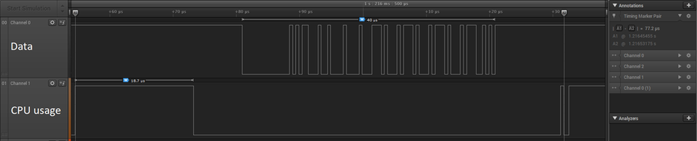

1. what is the formula to calculate timeout to initialize a strip with N LEDs on it?
2. How long does it take to  digLED_Set_RGB () and  digLED_Set_DIM () commands?
Currently it's taking over 200us to do that and sounds too long to me. I read in release note that

2. The "Set" commands all last the same amount of time to be transmitted. The transmission mode, however, can impact CPU load during the transmission as follows:
- Interrupts mode, CRC enabled:
The total time is the interval between the A1 and A2 markers - 68 us. This is the time between calling the digLED_Set_RGB() function, and digLED_Callback is called with the "TRANSMISSION_COMPLETE" event. The second channel represents the CPU usage during the transmission (Frame formatting, CRC calculation, and the transmit interrupts - in total 18.5 us)
- DMA mode single frame, CRC enabled:
Total time is 77 us, with the total CPU load 18.7 us. DMA mode is not more efficient than interrupts mode for single commands.

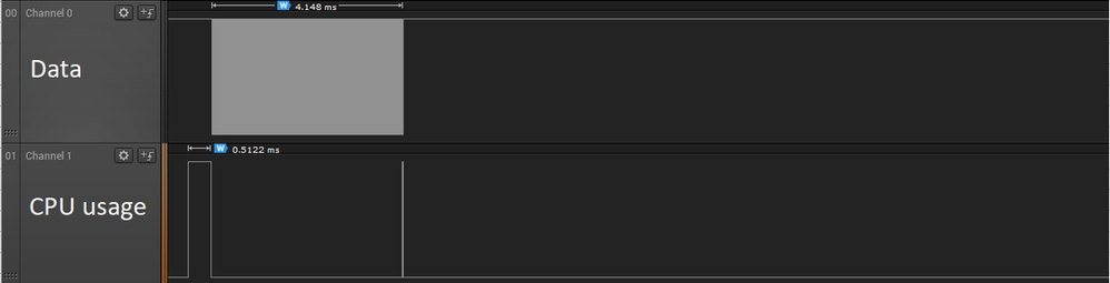

- Block mode DMA, CRC enabled:
This capture represents the Block transmission of 80 SET_RGB or SET_DIM commands using the single "digLED_Send_Cmd_Block" function. This is the most efficient way to address every LED in the strip. In this case, all the processing is done before the transmission begins (512 us) after which DMA sends the 80 frames (4.14 ms) - so about 6.4 us CPU processing time for each frame. The screenshots above were taken using S32K144 running at 80 Mhz, 40 Mhz FlexIO clock, cache enabled.
The times you are citing from the release notes refer to the CRC calculation time for one frame. It was measured on S32K116 as it is the least powerful. Those times are included in the CPU usage shown in the graphs.
