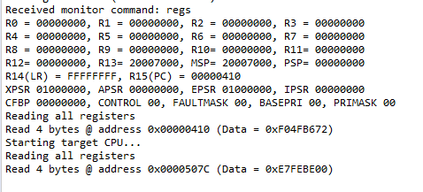

benjamin_dollin
Thank you very much for the fast response, it seems to work.
But now I'm stuck on this problem:
It just stops on this point and did't finish flashing.
Do you also have a fast solution for this?
4,343 Views
razva_tilimpea
Can you try to use openSDA?
Razvan
4,343 Views
razva_tilimpea
This capture doesn't include any error.
Could you share more details?
Razvan
4,342 Views
benjamin_dollin
There occur no error, it just hang on this point.
I use J-link Base.
Could it be a hardware problem ?
4,342 Views
