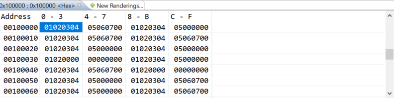

These are my datas. I want to write to flash memory with the most efficient way but It fills the remainder of the 8-byte section with 0s. But I want to write other data to come

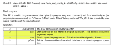

in this case, it doesn't matter what the alignment is. Smallest portion of flash which can be programmed is one phrase which is 8 bytes. Cumulative programming within one phrase is not allowed, the phrase must be in fully erased state before programming.
It's mentioned also in the SDK user manual:
If you want to avoid the alignment of char arrays to 4 bytes anyway, you can put them to structure - then there won't be those gaps.
