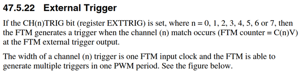

The FTM module has Initialization trigger (INIT_TRG) that is generated at the start of each FTM (PWM) period.
And EXT_TRIG that is generated on an FTM channel match.
This triggers can be routed from FTM through TRGMUX to FlexIO and be used as triggers for the I2S transfer.
