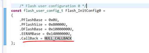

Senlent
Hi@vishwadn
This is a known bug and has been fixed in the new version.
You can modify it like this:
"peripherals_flash_FTFC.c"
4,292件の閲覧回数
346500452
Hi@Senlent
What do you mean by the new version? SDK or S32DS?
And where can find the table in picture.
