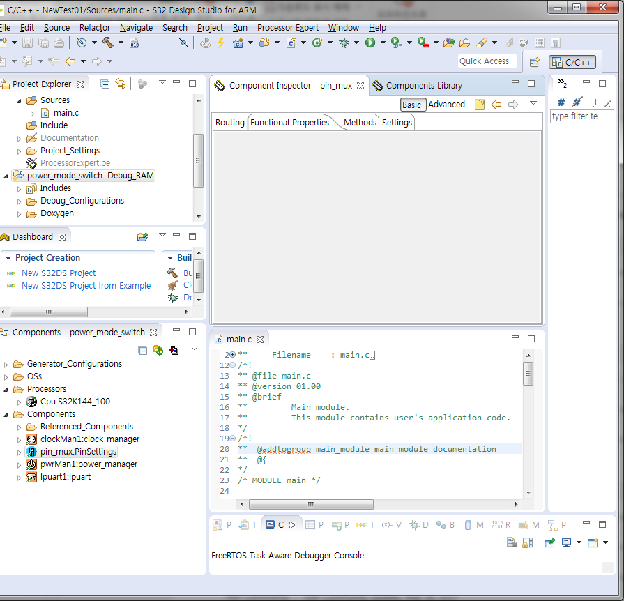

The customer is using S32 DS v1.3 and an example of SDK RTM v1.3, but when they clicked the pin_mux, they couldn't configuration in 'Functional Properties' as below.
Could you check this symptom?

Hello Kate,
This issue is currently under investigation as it has also been reported here:
https://community.nxp.com/thread/453118
We will come with an update on the issue as soon as we identify the root cause

Hi, I have same problem in Functional Properties at S32DS ver1.3.
Has this problem been resolved?

Hello Sohyun,
Yes, this problem has been fixed in S32 SDK EAR 0.8.5. All the versions form this one to the present display the correct information in the Functional Properties tab

Cezar,
Thanks for the update. Hopefully NXP can address this quickly. I have to add code manually in main.c to temporary fixes to two projects because I cannot alter the Functional Properties.
