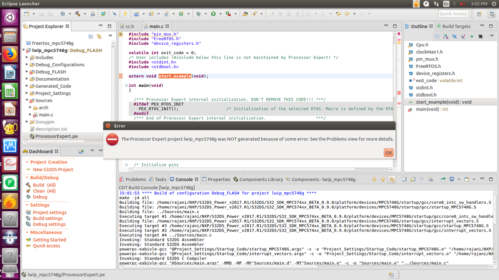

I have go through the steps provided by you. but still i got the same error. Attached screenshot for error information.
FYI. I am not getting error for all the example code which are provided by s32 design studio. for some of the examples, i cant able to fetch the source files and that's why come through error message like this.
If you provide lwip source files - sdk (.zip) for this specific board or platform then also it will be good. Screenshot from 2019-01-25 15-02-58.png

Hi Rajani Sureja,
Unfortunately, SDK is not supported under Linux environment. You can use a Windows system to run the examples and to use the SDK.
You can find the LWIP sources in SDK/middleware/tcpip and you should include:
   lwip + subfolders
   tcpip_stack/ + subfolders(without ports/platform)
   tcpip_stack/ports/platform/<device>
Rares
