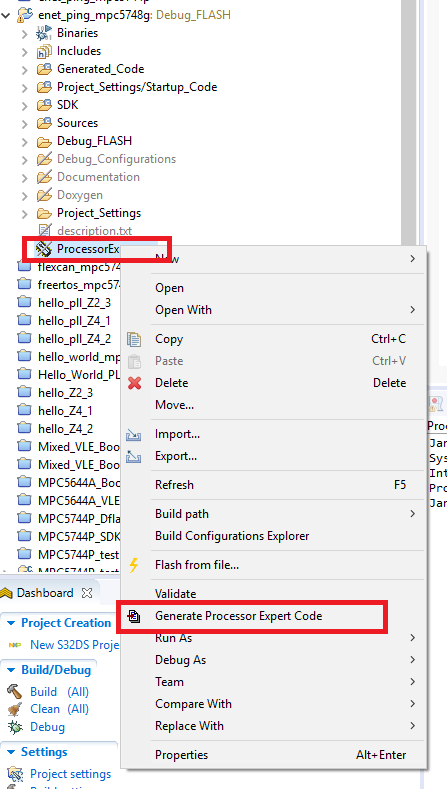

stanish
Before you compile the project, please generate the configuration files first.
Right click on .pe file and select "Generate Processor Expert Code"
When the code is generated press Build button
hope it helps.
Stan

rajani_sureja33
Hi Sliva,
I have go through the steps provided by you. but still i got the same error. Attached screenshot for error information.
FYI. I am not getting error for all the example code which are provided by s32 design studio. for some of the examples, i cant able to fetch the source files and that's why come through error message like this.
If you provide lwip source files - sdk (.zip) for this specific board or platform then also it will be good. Screenshot from 2019-01-25 15-02-58.png

raresvasile
Hi Rajani Sureja,
Unfortunately, SDK is not supported under Linux environment. You can use a Windows system to run the examples and to use the SDK.
You can find the LWIP sources in SDK/middleware/tcpip and you should include:
   lwip + subfolders
   tcpip_stack/ + subfolders(without ports/platform)
   tcpip_stack/ports/platform/<device>
