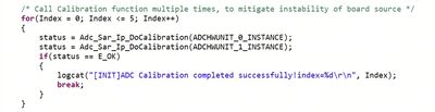

Hello.
Do I have to call calibration function every time when I want to start a SW triggerednormal conversion on ADC_SAR? Or I just need to call it during the initialization?

Hi @jetty_1012,
Only during the initialization:
AN12217 S32K1xx ADC guidelines, spec and configuration
https://www.nxp.com/docs/en/application-note/AN12217.pdf
