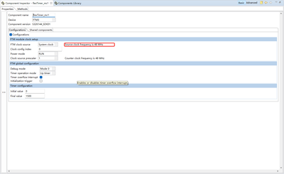

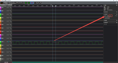

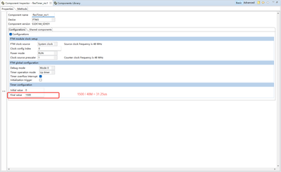

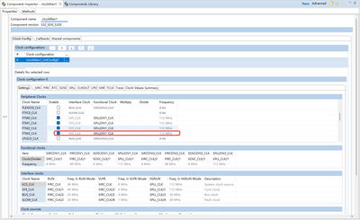

the project in the attachment is to activate the HSRUN mode of s32k144, start the timer, and detect the timer function through PTD6. Currently encountering some issues (RUN MODE does not have these issues)
1. The working frequency of ftm3 is configured as 112M, but this configuration has not taken effect
ftm0 ftm1 ftm2 are also 48M
2. Configure 'Final value', but the timer did not generate the expected timing time
