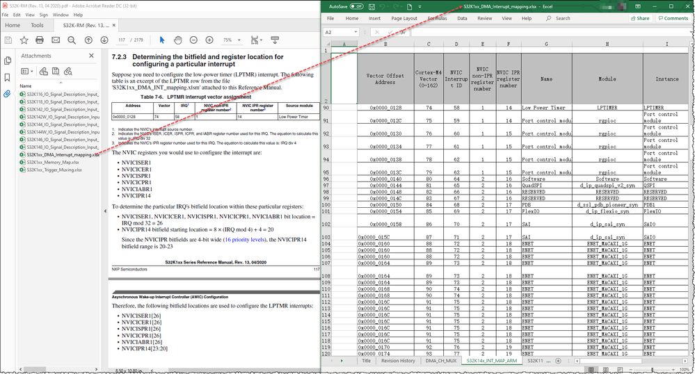

Hello! Im trying to configure ADC trigger interrupt for my board but I dont understand
S32_NVIC->ICPR[1] = 1 << (39 % 32); /* Register ADC0 interrupt */
S32_NVIC->ISER[1] = 1 << (39 % 32); /* Enable ADC0 interrupt */
S32_NVIC->IP[39] = 0xA0; /* priority is 10 */
Why do we use those number value or what do they represent to set there?

Hi IuliaB,
Please refer to the "7.2.3 Determining the bitfield and register location for configuring a particular interrupt" of S32K1xx MCU Family - Reference Manual
Determining the bitfield and register location for configuring a particular interrupt.pngDetermining the bitfield and register location for configuring a particular interrupt.png
Robin
