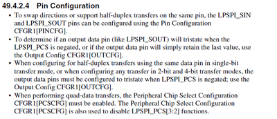

"The functions implemented at the SDK for LPSPI do not have "native support" for 3-wire. So it required to make some changes to support half duplex mode." according to this sentence I have changed to support half duplex mode. I changed to support half duplex mode these functions LPSPI_DRV_MasterInit(..), LPSPI_SetPinConfigMode(..) according to reference manual.
Below is the only information I found in the reference manual about tristate SPI.
According to this information my CFGR1 value is Hex:0x6000001.
lpspi_pin_config_t pinCfg is = LPSPI_SDO_IN_OUT.
lpspi_data_out_config_t dataOutConfig = LPSPI_DATA_OUT_TRISTATE.
bool pcs3and2Enable = true.
Please confirm that configuration and CFGR1 value.

The S32K1 does not need to have HW modification, if you configure MOSI as input and output you don have to use any pin for the MISO signal in the PORT module. Also for the other device, the connections depend on its specifications.
Regarding the Configuration Register 1 (CFGR1) value, PINCFG configures SOUT as input and output data, OUTCFG configures the output data as tristated when chip select is negated and PCSCFG configures PCS[3:2] for chip select function. For 3-wire SPI CFGR1 = 0x6000001 is correct, the other bits depend on your application.
