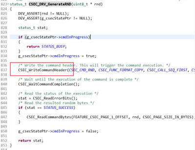

    When using the CSEc module CSEC_DRV_GenerateRND function to generate random numbers, the program will get stuck at the position where the command is sent. What is the specific reason for this phenomenon?

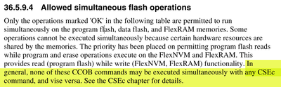

Regarding CSEc and EEE:

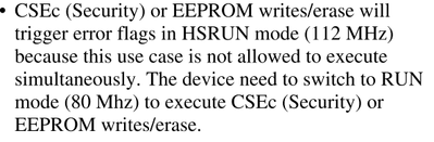

 Also the device can't run in high speed mode:
 Notice that SDK drivers do not check if EEE/flash operation is running when CSEc functions are going to be executed. I was already asking for this but it is not implemented yet. Currently it is up to user to check this.

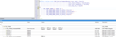

    CSE_PRAM cannot be accessed because of insufficient permissions. How to set access permissions?
4,211 Views
ZEROOO
    This problem is urgent, please provide help.I would like to know if calling CSEC_DRV_GenerateRND generates random numbers to determine whether partitioning is successful. If checking CSE_PRAM is always "can not access" and "skipped", is this normal? How to determine partitioning is successful?

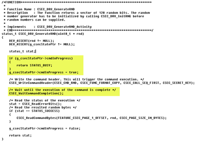

    I assume that if the CSEc command conflicts with other memory operations, the corresponding register will report a failure.There is code in the SDK to detect if the EEE/flash operation is executing.CSEC_DRV_GenerateRND can be called directly after initialization. If it is placed in a periodic task, it will get stuck.
* @brief Waits for the completion of a CSEc command.
* This function waits for the completion of a CSEc command.
static inline void CSEC_WaitCommandCompletion(void)
while ((FTFC->FSTAT & FTFC_FSTAT_CCIF_MASK) == 0U)

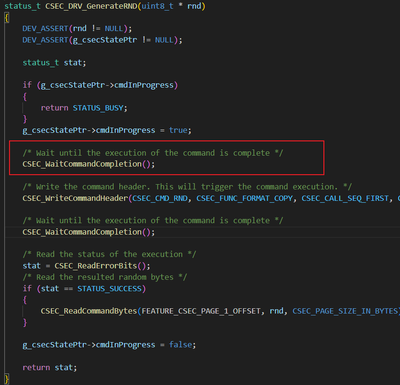

The problem is that CSEC functions check only if another CSEC function is running using SW flag cmdInProgress. It does not check CCIF bit:
CCIF flag is checked after triggering of the command. So, this function will not recognize if another flash operation is running. That's what I was talking about.
I would try to call CSEC_WaitCommandCompletion() function before calling the function to be sure all flash operations are finished. You can also try to disable interrupts for test purposes.

    I have tried this, checking the CCIF bit before executing the command, but I still have problems writing to the command header, and turning off the interrupt doesn't help.Are there any other lines of inquiry.
