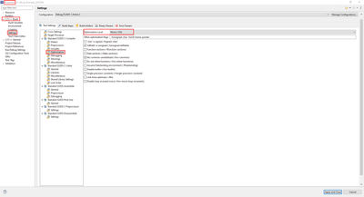

hi,
im trying to read a led using the function Dio_ReadChannel. my code is written as shown below:
while (1)
Dio_WriteChannel(DioConf_DioChannel_myled, STD_HIGH);
TestDelay(5000000);
Dio_ReadChannel(DioConf_DioChannel_myled);
if ( Dio_ReadChannel(DioConf_DioChannel_myled) == true)
x = 1;
else
x=0;
im always getting x as an optimized out:
i want to see the value of my variable can anyone help me?
thank you.
5,500 Views
VaneB
Hi @AhmadTurkmani
Go to the project properties -> C/C++ Build -> Settings -> Optimization.
5,550 Views
VaneB
Hi @AhmadTurkmani
It means you compiled an optimization level different than the default, so the gcc optimizer found that some of your variables were redundant in some way that allowed them to be optimized away. Compile with optimization disabled if you want to see such variables (this is generally a good idea for debug builds in any case).
B.R.
VaneB
5,529 Views
AhmadTurkmani
How can i disable optimization?
5,501 Views
VaneB
Hi @AhmadTurkmani
