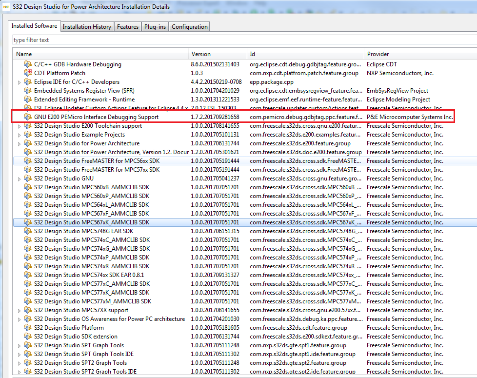

martin_kovar
which version of GNU E200 PEMicro Interface Debugging Support you have installed? Newest version is 1.7.2.
Could you please try to install the newest one and let me know, if this solves your problem?
Martin

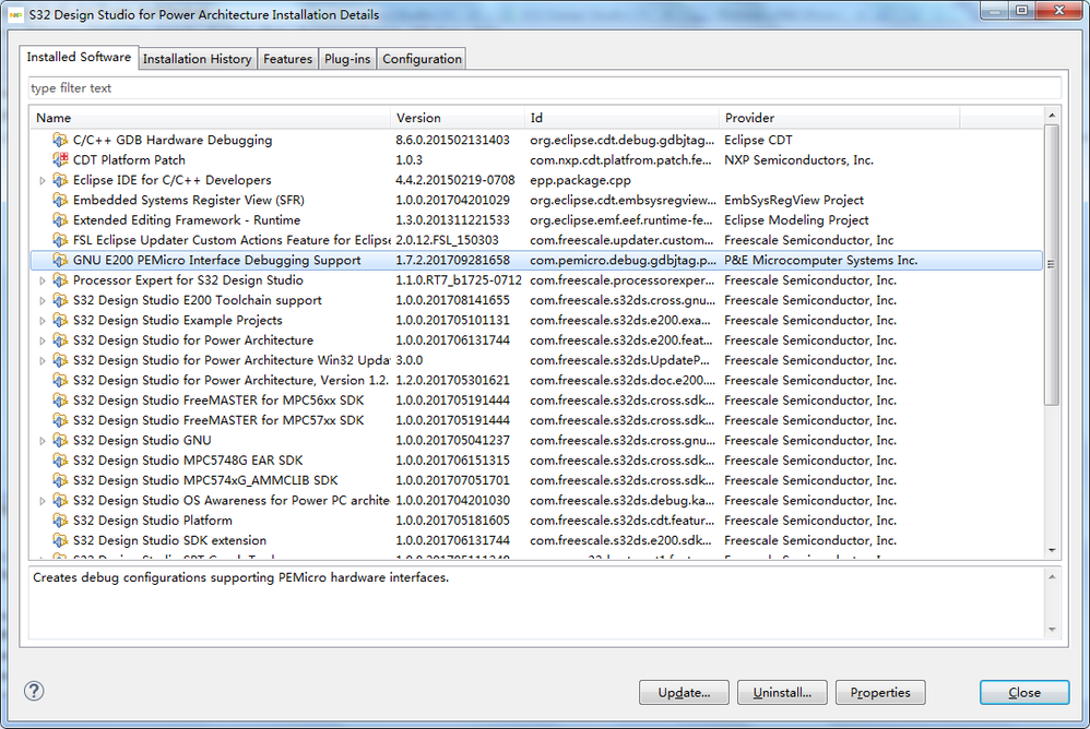

jeromeli
Hi Martin,
My installation is already the newest one.
