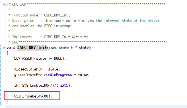

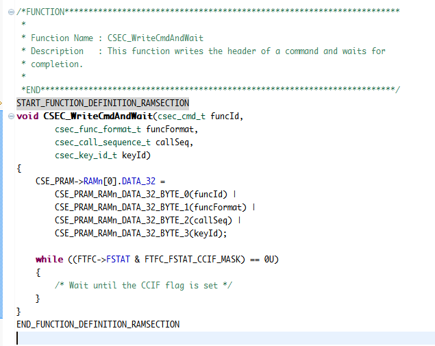

In Csec Driver and Flash Driver, some function is placed in RAM. Use "START_FUNCTION_DEFINITION_RAMSECTION" and END_FUNCTION_DEFINITION_RAMSECTION.
for example:
The csec init driver will start the system tick.
When I init the csec driver, then call some cesc or flash function that need run RAMCODE. when the code run to the RAMCODE, the system will be reset.
if I disable the system tick, those function will be run succeed, and there is no system reset.
I don't know why it happened. I don't know why the system tick will  impact the ramcode.
Anybody can explain the theory or reason to me?
I don't know disbale the system tick will really run those function succeed every time.
