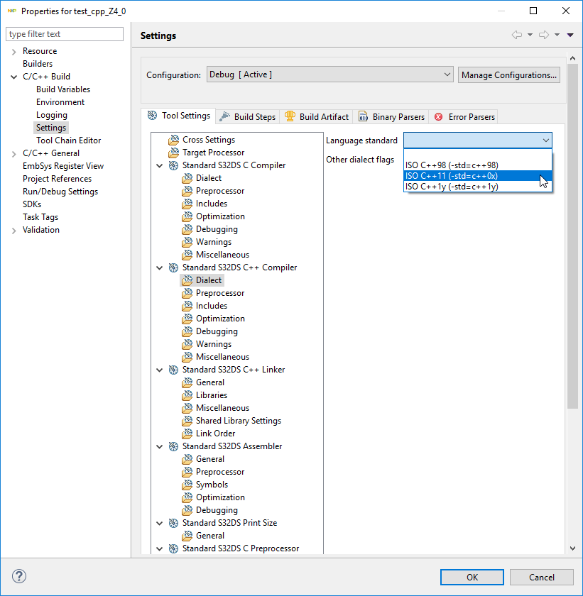

fab1
Unfortunately yes, I tried with both C++98 and C++11. The error is the same in all cases.

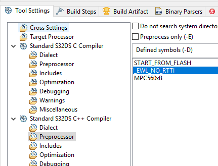

b48014
Hi Fabrizio,
Could you try to set _EWL_NO_RTTI define in the project settings?
PS: But i suggest you to use the newlib instead of ewl:
Dmitry

fab1
Hi Dmitry,
Thank you! That solved the problem in the little example I had.

jiri_kral
did you set the C++ dialect to C++11 in project properties/settings?
