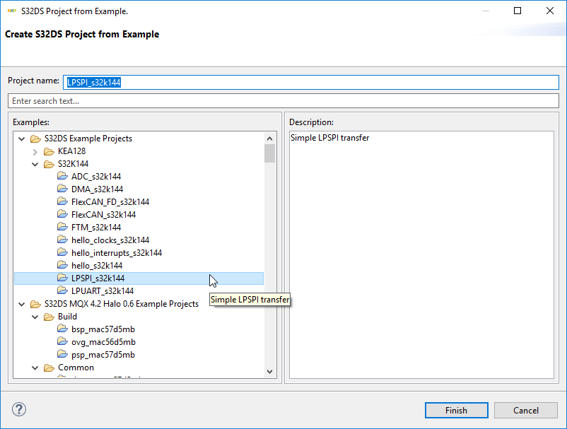

jiri_kral
I see. In my opinion is better idea start with LPSPI_s32k144 example (in case that your MCU is S32K144). This example is not using SDK (and processor expert) and you can learn how SPI works.
Jiri
2,991 Views
madogz28
I'm working on the S32K148, but I think I can use the example.
Thanks.
