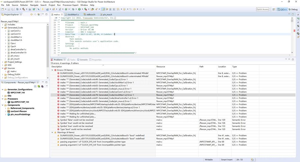

Hello:
   some errors are reported when the official example is compiled
   my computer has been rebooted.
   the c/c++ index has been rebuilt.
   thanks!

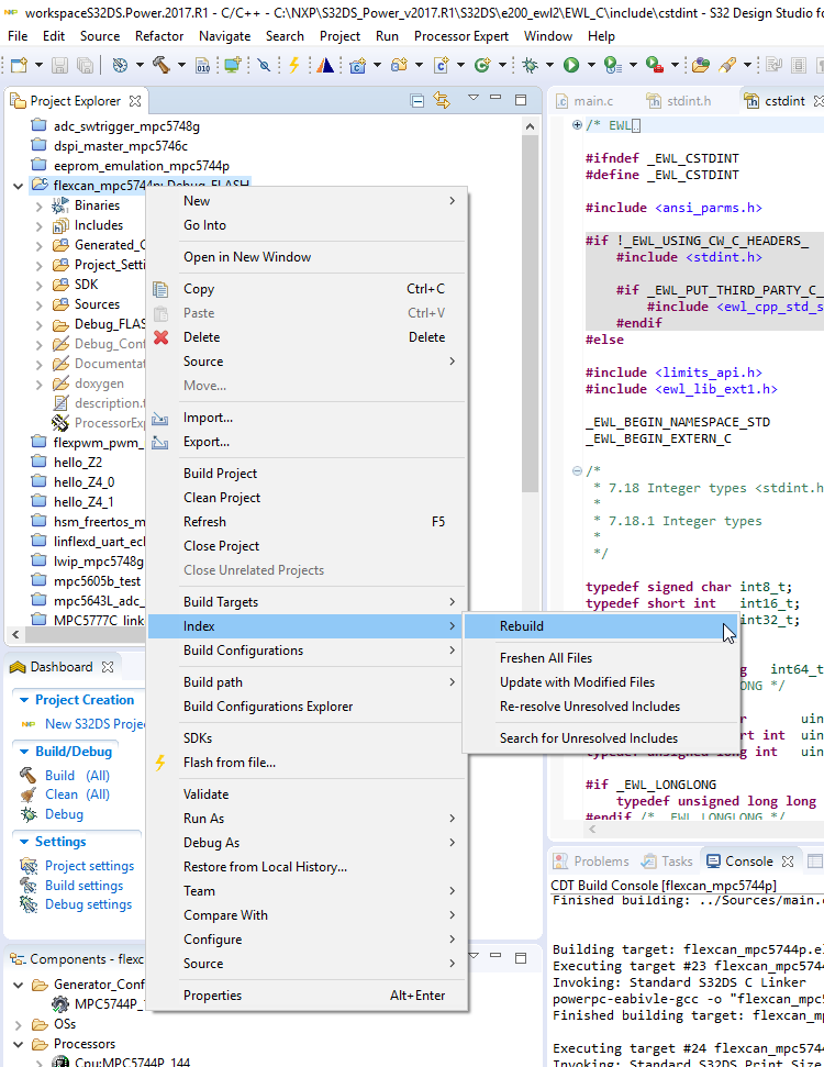

what about your .elf file, is built properly - can you see it in Binaries folder in your project?
If yes - you can try to refresh your project (right click on project name -> refresh (or F5 key)) and rebuild index:
Then clean project and re-build it again. The error message should disappear.
Jiri
