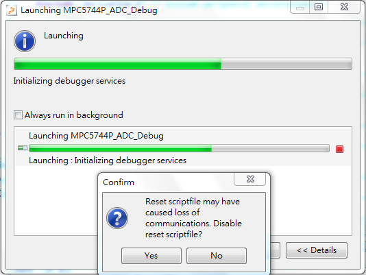

That is my first time using s32 ds when I debug it always have this problem.  i don't understand what's the mean.
it always run to 61% initializing debugging services and stop.
So how can I solve this problem? thanks a lot!

This looks like a connection issue between P&E probe and the device.
Please make sure the jtag header is correctly oriented.
You can also experiment with the Delay after reset and communication speed:  https://community.nxp.com/message/934308?commentID=934308#comment-934308
I'd also recommend you to start with RAM based project - build RAM_Debug build configuration
Are you able to connect to the device?
Thanks!
Stan

thanks for your response! I ignored that usb voltage was not enough.
