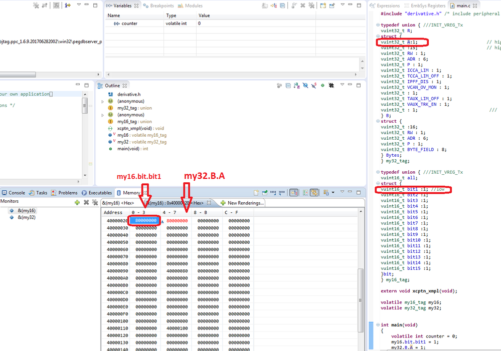

   I have a qustion for S32DS 5744P lib about C union struct 。

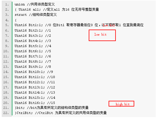

q333444ew
Hello,Stanislav
I think he want to the order of bitfields. Is it means for vuint32_t data the order is from high side to low side?For vuint16_t data, the order is from low side to high side? I am not sure. Could you help me?
Thanks!
Regards!
Xinyu

stanish
The order of items in bitfields is the same regardless of vuint32_t or vuint16_t data type.
First item in the bitfield definition is the most significant bit regardless of its name.
So if you set just the first bit of the structure and read it back as uint16_t value you get value 0x8000.
For uint32 the value is 0x80000000.

stanish
I created a simple test case and I can see the bitfields respects the same endianess in both cases:
Can you please send us the example project for analysis if it still does not match on your side?
Please check this posts related to reversing bitfield allocation:
https://community.nxp.com/message/929337
Thanks!
Stan
