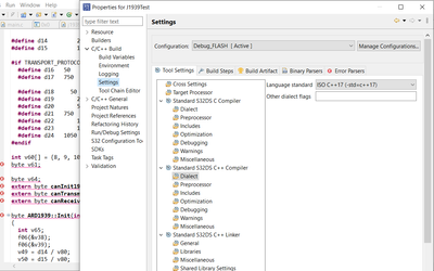

I am trying to bring in c++ code from another project into a new one, but it is not recognizing "byte"s, The dialect is on c++17 so what should I do? I don't really want to convert everything to unsigned char

Okay so it turns out that I should have noted that this is arduino code I am porting from , which uses byte as "uint8_t." Thank you for the help though it turns out that using the actual cstddef would be incorrect in this situation.

Any suggestion on what to do to make the compiler see byte?

Hello @pb632146,
In C++17, std::byte was introduced as part of the standard library to represent raw byte data. If your code isn't recognizing byte, ensure you are including the correct header:
cpp
#include <cstddef> // for std::byte
By including this header, your project should properly recognize std::byte. This eliminates the need to convert every instance to unsigned char.

I see, do I need to add std:: on to all the byte declarations? or is there a define I can do to avoid finding and adding every instance of byte
