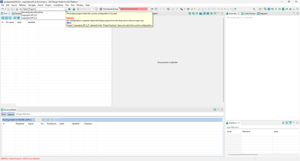

Hi everyone,
I'm trying to use the pin configuration tool for S32K376 for the first time

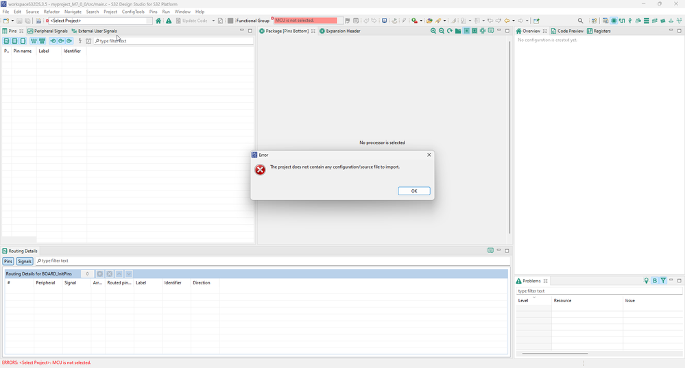

After selecting my project on "<Select Project>" box, I'm getting the next error, that I don't know how to solve. "The project does not contain any configuration/source file to import"
I created the project from "New->S32DS Application Project" as follows:
I can build the project with no error. I switch to pin configuration tool and this is what I see
When I select myproject, I get the error.
Any idea of what I am missing?
Thanks!!

Hi @rogi,
It seems you are using RTD 3.0.0. This release does not support S32K376, please refer to the release notes for RTD 4.0.0/5.0.0:

Thanks for the answer.
Where can I find the SDK for the S32k376 you show in your picture?
I manage to do it for the S32k396 installing autosar RTD extension on S32DS, but I cannot find one that supports S32k376

rogi
Thank Julián, problem solved

Hi @rogi
When creating an application, you need to attach the RTD/SDK to the project:
