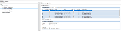

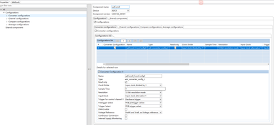

Why can't I use pdb to trigger 8 adc0 channels? Is there a problem with my configuration? I can trigger adc normally when I use only 6 channels through pdb, but I can't trigger access interrupt once more than 6 channels are used, and 6 can only be triggered when the sampling time is set to 1? Using other samples will not work (I have tried 0-20,24,36, 72,255, etc.) I set the sample time to 12 and can only trigger 4 normally, here is my configuration code:

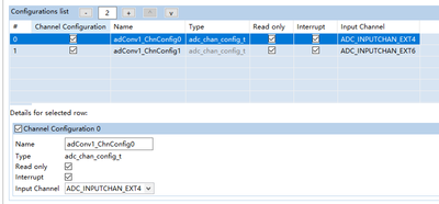

static void ADC1_Init(void)
g_ADC_Val[ADC_PWR_IN].conf = (adc_chan_config_t*)&adConv1_ChnConfig0;
g_ADC_Val[ADC_MCU_SENSOR].conf = (adc_chan_config_t*)&adConv1_ChnConfig1;
ADC_DRV_ConfigConverter(INST_ADCONV1, &adConv1_ConvConfig0);
ADC_DRV_AutoCalibration(INST_ADCONV1);
ADC_DRV_ConfigChan(INST_ADCONV1, 0, g_ADC_Val[ADC_PWR_IN].conf);
ADC_DRV_ConfigChan(INST_ADCONV1, 1, g_ADC_Val[ADC_MCU_SENSOR].conf);
INT_SYS_InstallHandler(ADC1_IRQn, &ADC1_IRQHandler, (isr_t*) 0);
INT_SYS_EnableIRQ(ADC1_IRQn);

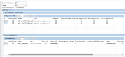

static void PDB1_init(void)
PDB_DRV_Init(INST_PDB1, &pdb1_InitConfig0);
PDB_DRV_Enable(INST_PDB1);
PDB_DRV_ConfigAdcPreTrigger(INST_PDB1, 0, &pdb1_AdcTrigInitConfig0);
PDB_DRV_ConfigAdcPreTrigger(INST_PDB1, 0, &pdb1_AdcTrigInitConfig1);
PDB_DRV_SetTimerModulusValue(INST_PDB1,(uint32_t) sg_PDBcounter);
PDB_DRV_SetAdcPreTriggerDelayValue(INST_PDB1, 0, 0UL,(uint32_t) 20 );
PDB_DRV_LoadValuesCmd(INST_PDB1);
PDB_DRV_SoftTriggerCmd(INST_PDB1);
The above code adc1 can be polling normally triggered, but adc0 can never trigger 8.
1,585 Views
Detective
The first eight bits are the channels of adc0, and the last two bits are the channels of adc1

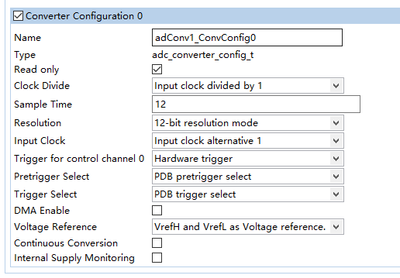

When I set the sampling time to 1, sampling only 6 channels will trigger normally, sampling 8 channels will trigger only once, and the 8th channel does not convert, maybe there is a problem with the 7th channel conversion flag? I don't know how to configure it
When I set the sampling time to 255, sampling 8 channels triggers only the first channel, and no more after that
Shouldn't the longer the sampling time be the more accurate the result? Why does it have such a big impact on the sampling value? I have tried many values wrong in the middle, and now I am not sure how to configure it
1,558 Views
PetrS
you set PDB for continuous mode, so the PDB counter modulo/period must be longer than total conversion of all triggered channels. So what is the value of "sg_PDBcounter" and does it correspond to expected ADC conversion time? Or try to do not use continuous mode and start PDB again after ADC conversion is completed.
