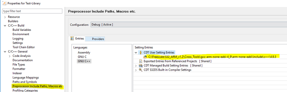

I got some problems when changing from ewl to newlib in order to use to Heap.
When including #include <string>, I got: Unresolved inclusion: <string> error.
I am able to do a #include <c++/4.9.2/string>, but I am not able to use std::string nor am I allowed to use the standard namespace: using namespace std;
Is it possible to use any of the standard library functions that needs dynamic memory allocation in S32DS?

reneherrero
Hi Martin,
Any updates on this?  I'm having the same problem.  Creating a library with something as simple as what's below fails:
#include <string>
class C {
public:
    std::string m_string;
Note that the library does compile.
I pocked around and found that by updating the Preprocessor Include Paths, the "Unresolved inclusion: <string> error." goes away.
But, I still get a "Type 'std::string' could not be resolved" error and I wasn't able to get any further... bummer.
Looks like something in the "CDT S32 Built-in Compiler Settings" for C++ is off.
Note his piece does work fine on the Kinetis Design Studio.
René

IanMcelhenny
Was this ever solved? I am having a similar issue with the STL Vector Library. If I change the paths like you said it removes the error on the include, however the constructor is still unrecognized.
