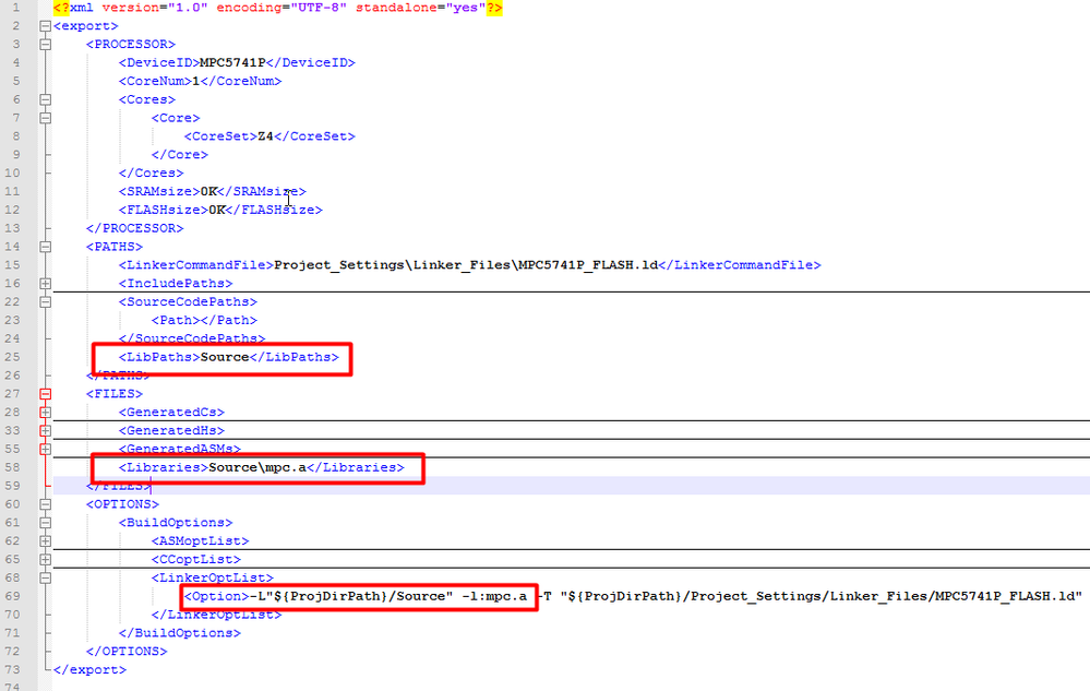

In the projectinfo.xml file, I tried to use libraries with the settings as showed in the following picture.
The library file is mpc.a.

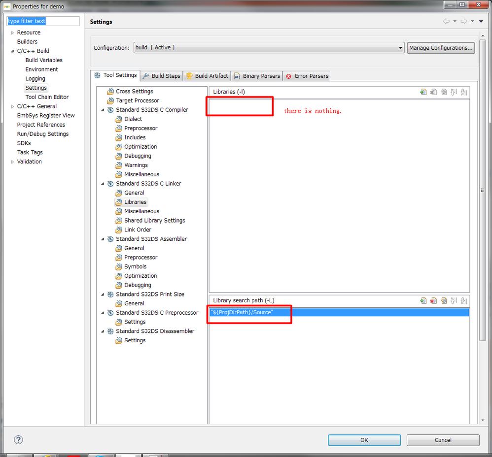

But after importing xml file , all configurations works but the library's configuration.
So I have to mannually add the library's name in order to compile the project successfully.
I have also tried to export the projectinfo.xml from an existing project with the right library settings.
But there is no "-l:mpc.a"  in the exported XML file.
Is there anything wrong with my XML file?

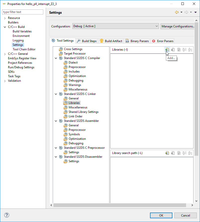

As a workaround you can add your libraries manually in project properties:
