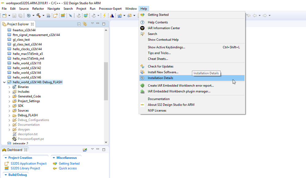

How S32 DS updates library files and restores library files?(I found that when I modified the library file, I couldn't recover. By the way, where is the withdrawal key for 32DS?)
much thanks!!!

what is your S32DS version (ARM, Power PC, Vision)? What you mean by library files? Your library files you need to maintain by yourself. Standard C libraries (EWL, NewLIB) aren't under user's control. Please share more details about your issue. Thank you.

My S32DS version is ARM.I am Writing a program to S32K 148.but the Official driver is changed by myself,I want to know how to get it back.by the way,S32DS for ARM Is there a recall function, and if so, where is it?thank you very much!

If you modified part of SDK, I'm affraid that only re-install can bring back original setup. There is no rollback action.
Other possibility may be uninstall that particular SDK and run update again - but I didn't try it:
