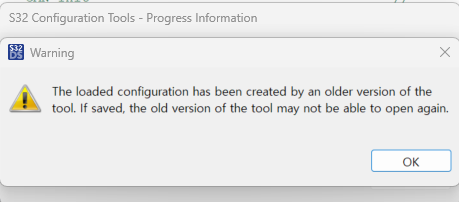

i am using s32ds 3.6.1version. rtd 4.0.0 , s32k344.
after i download rtd 4.0.0 and i open the porject.
but i can not see example project pinmap.
i got a message that project is old version.,
so i installed s32ds 3.5 version. but i get same issue.
and i failed install s32ds 3.4 version.
1. how i can see that project well? pin, driver, clock and so on.
2. i got a activation code for 3.4 version. but it is not work.
how i can install s32ds 3.4 version ?
i already have install file s32ds 3.4version. i download in nxp.
thanks for regards.

If it is a new project, it is recommended to use the latest S32K3 RTD 5.0.0 + S32DS v3.6.
Or refer to HOWTO: offline install S32K3 RTD 4.0.0 in S32DS v3.5
