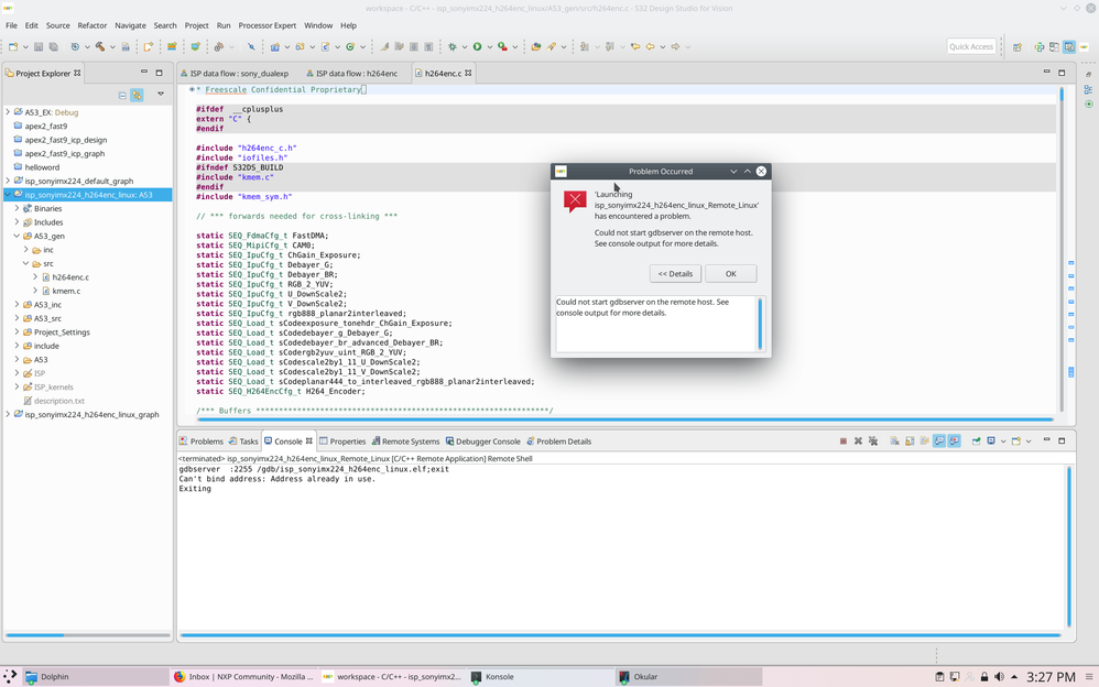

I am not able to debug
getting the following error..
gdbserver  :2345 /vsdk/ISP_Test_application.elf;exit
-sh: gdbserver: not found
please help me out soon..
Thanks in advance.

at present it is showing these error
Error during file upload.
Could not write file: /home/developer/workspace/ISP_Test_application/A53/ISP_Test_application.elf.
Read-only file system

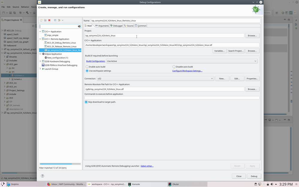

Um, this is strange error. So - what's is your debug scenario?
Typical remote debug scenario for S32DS for Vision - Linux target is:
- Host PC with installed S32DS for Vision v2.0 (doesn't matter if host PC is running under Windows or Linux)
- Linux OS running on target EVB  - ideally OS image which is part of S32DS for Vision v2.0
- Network connection between host PC and Target machine
Jiri

find the image below, and please let me what is the problemdebug config.pnggdb could not start.png

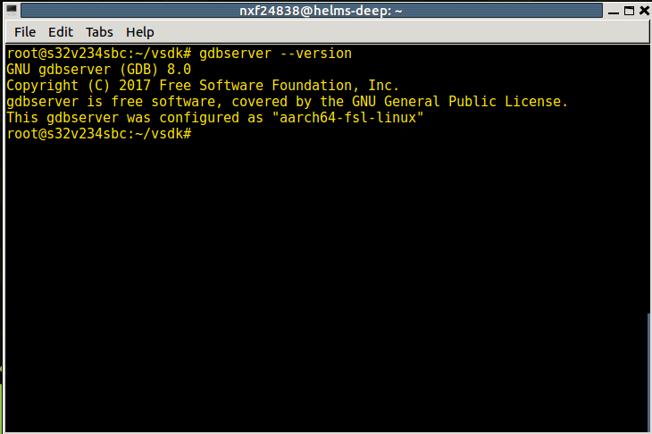

Make sure that you are running linux on your EVB. If everything is okay - check if gdbserver is present on your EVB - simply login to your EVB and try to run gdbserver --version . You should see something like this:
Jiri

there is no gdbsever on the target, so I should also install gdb on the target??
4,377 Views
jiri_kral
Official OS Image already contains gdbserver. In my opinion better idea is prepare new SD card with official OS image. Here is guide:
https://community.nxp.com/docs/DOC-335023
Hope it helps.
Jiri
