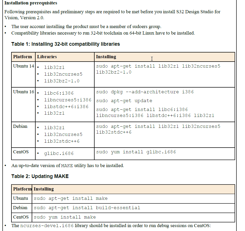

When I tried to build some projects from the exiting project examples I'm getting following errors;
how will i be able to overcome this??kindly check in the attached pics
and
Could not determine GDB version using command: /opt/NXP/S32DS_Vision_v2.0/Cross_Tools/gcc-aarch64-linux-gnu-4_9/bin/aarch64-linux-gnu-gdb --version
/opt/NXP/S32DS_Vision_v2.0/Cross_Tools/gcc-aarch64-linux-gnu-4_9/bin/aarch64-linux-gnu-gdb: error while loading shared libraries: libncurses.so.5: cannot open shared object file: No such file or directory

you need to install some 32 bit libraries on your OS:
More details you can find in pdf_getting_started.pdf manual located in
[YOUR_S32DS_INSTALL_PATH]/S32DS/help/pdf .
Hope it helps.
