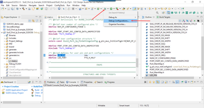

Also, you mentioned that you used the Run option, please try using the Debug option and the configuration to be built is FLASH (Debug_FLASH).

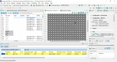

As per the schematic, the changes have been made in the configuration tab. Specific to the LED D33, the pin allocation and the changes made on the code are attached. Stil the led not blinking.
As i have stated earlier , run configuration tab and the avilable options showing is only these, out of that which option has to be selected to flash the code on to the board? (Please find the attached jpg file named "Run configuration options").
Also if i have slected debug configuration option (FLASH (Debug_FLASH).) how can I analyse the code is running ? how can i able to know the LED blink as the debug configuration make the code to pause at each instance?

You are still selecting the Run Configurations instated of Debug Configurations. Please use the option shown in the attached images.

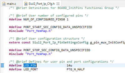

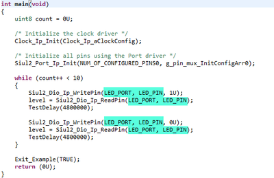

Also, the example code configures the pin using a label to identify it. I suggest configuring the corresponding LED pin as it was by default. If you put a label in the pin configuration, Config Tools generate two defines in Siul2_Port_Ip_Cfg.h file, these are the ones that you can use in Siul2_Dio_Ip_ReadPin().

As per the earlier conversation, making the default pin configurations (PTG30 , F5 , GPIO 222) Please find the attached eerors after the build.

When you create the project from an example, did you click Update Code at Config Tools?
Also, if you put a label in the pin configuration, generate two definitions that can be used in the functions.
