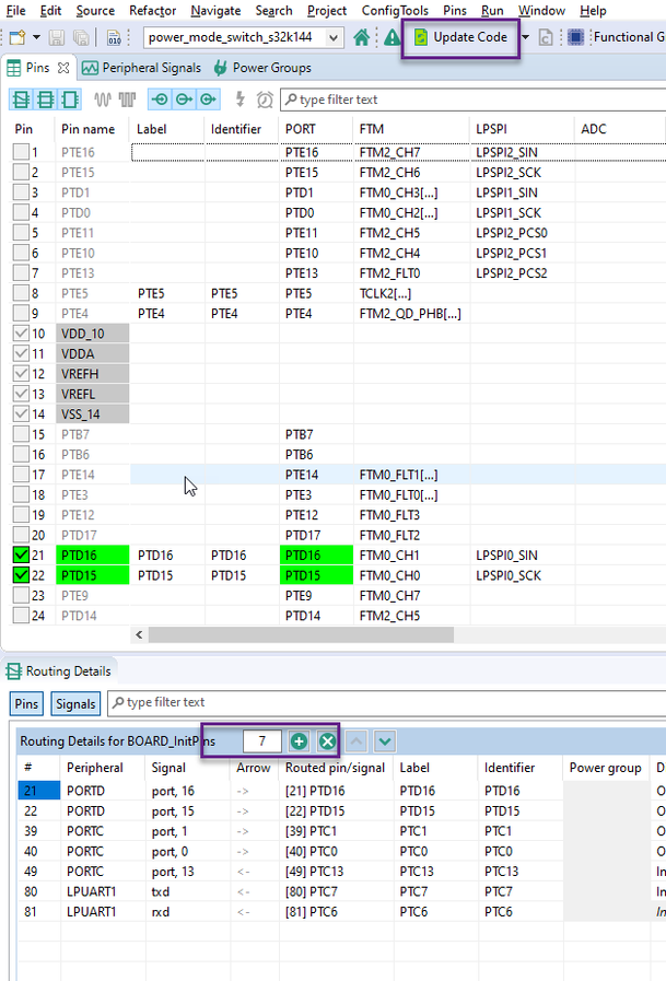

6,290件の閲覧回数
samcs
Only got one warning,
samcs_0-1648047986451.pngsamcs_0-1648047986451.pngsamcs_1-1648048033950.pngsamcs_1-1648048033950.png
I just wondering, why S32 Design Studio for ARM IDE, can handle More functions assigned on one pin, the generated code, here,PTA4, assigned  2 functions, but not affected the Macro definition in pin_mux.h.
 NUM_OF_CONFIGURED_PINS
6,282件の閲覧回数
danielmartynek
JTAG_TMS/SWD_DIO is a single function of the PTA4 pin (ALT7).
6,273件の閲覧回数
samcs
Thanks, so if the alt functions be configured both, then the generated code will configured twice?
one pin will configured twice, then the NUM_OF_CONFIGURED will be 2 for one pin?
6,269件の閲覧回数
danielmartynek
Yes, I just tested it (PTA4, PTC3) and indeed the NUM_OF_CONFIGURED_PINS0 increments.
Also, there is no warning for PTC3.
I will report it.
Thanks for pointing it out.
