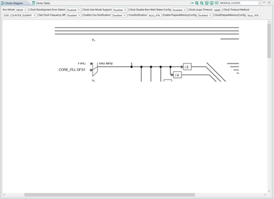

The Clocks diagram in my S32DS is partially rendered, and completely disappears if I scroll around. Is this a know issue? How can I fix this?
I have tried reinstalling design studio entirely but it didn't help

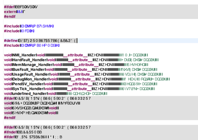

font is also broken now
