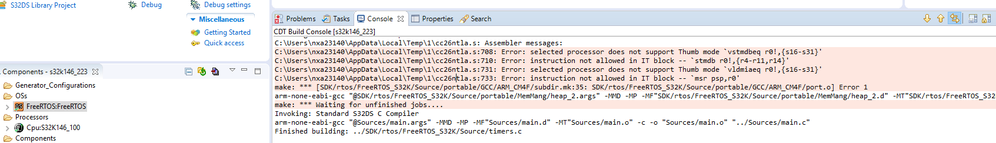

  • s32DS 2.0 for ARM add FreeRTOS, generate code for FreeRTOS, it had happened below error.

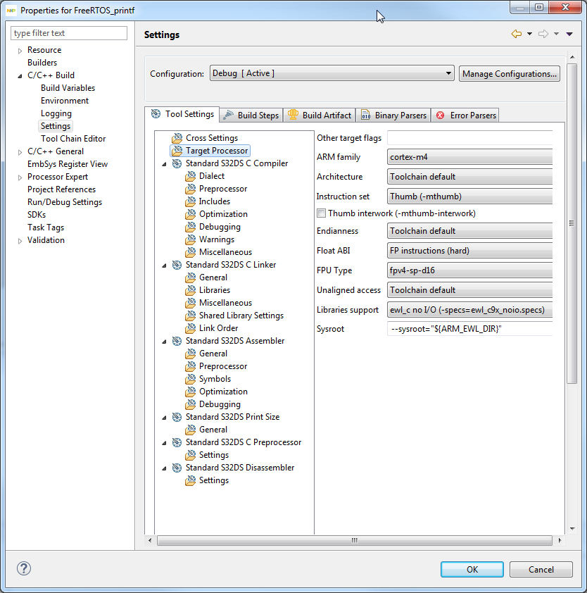

you need to enable FPU:
Jiri
