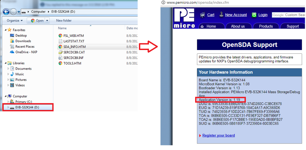

There are some helpful dual edge capture examples outwith the cookbook (eg Frequency and Duty cycle calculation using dual edge capture and https://www.nxp.com/docs/en/application-note/AN5303.pdf ) , but trying to work with them has problems with the debugger not working on 2018.R1 and trying to merge them with projects in the cookbook reveals differences in the naming of many values in S32K144.h.

I've checked the example and it works fine on my machine with S32DS 2018.R1. Could you possibly provide us with more info about the debugger issues? can you check what is the OpenSDA firmware version on your board?

Thanks, updating OpenSDA firmware got the debugger working, but the AN5303 example still doesn't work with 0 displayed for the capture values. I have started a new thread about this and will leave this one about the debugger issues. https://community.nxp.com/message/991945

Thanks, after updating OpenSDA the debugger works with AN5303.
