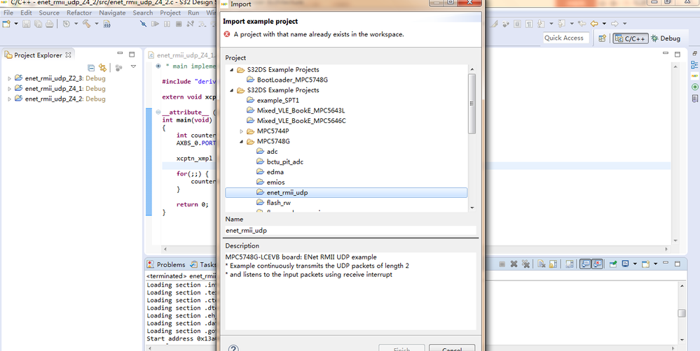

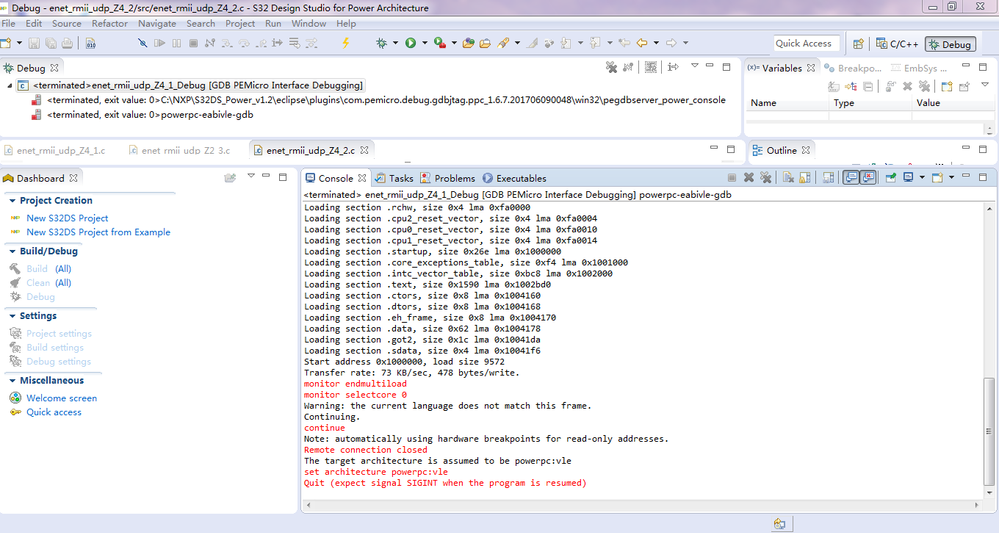

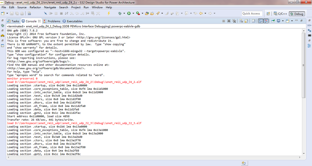

Hello all, a problem occurred when I debug the enet_rmii_udp project in MPC5748G from the S32 Design Studio example. I cant debug the project successfully. The pictures below are the errors showed in S32 console tab when debugging this project.
Here are some other message you may need.
  1. S32 version: S32 Design Studio for Power Architecture v1.2.
  2. The enet_rmii_udp project: imported from S32DS Example Projects. And I didnt change anything.捕获.PNG
  3. I debugged the hello example project successfully using the same computer, same MPC5748G.
I really need your help. Thanks.

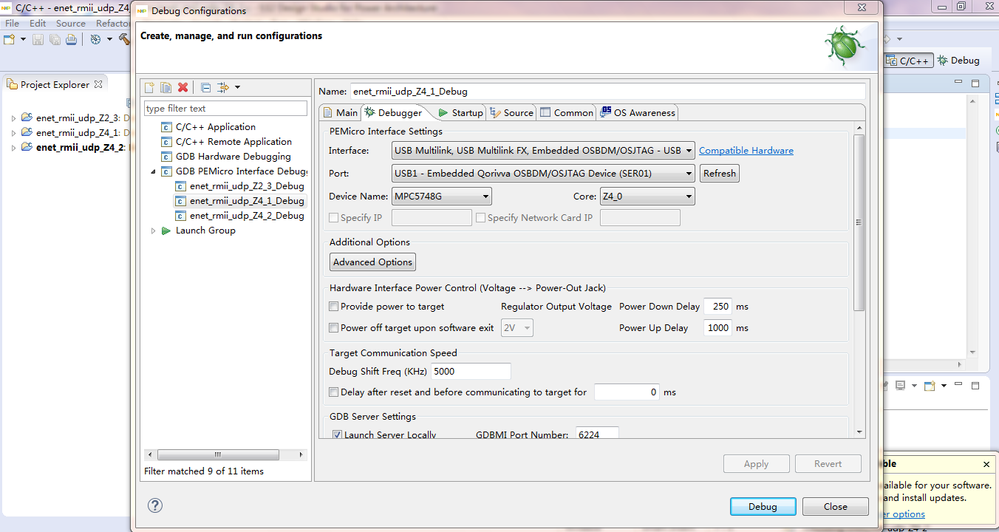

Do you use debug probe or you debug the example using USB and OpenSDA? Could you please send me you debug settings?

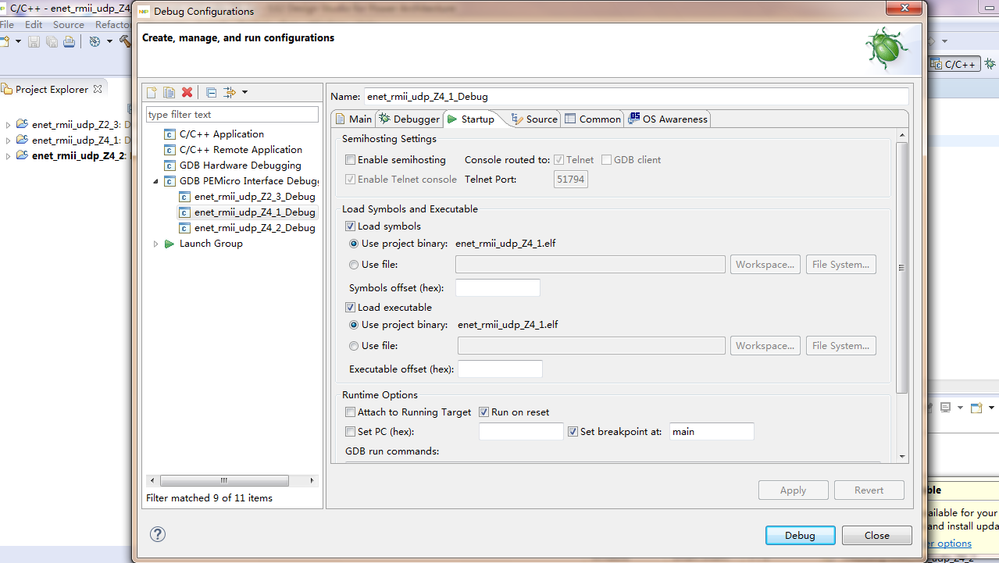

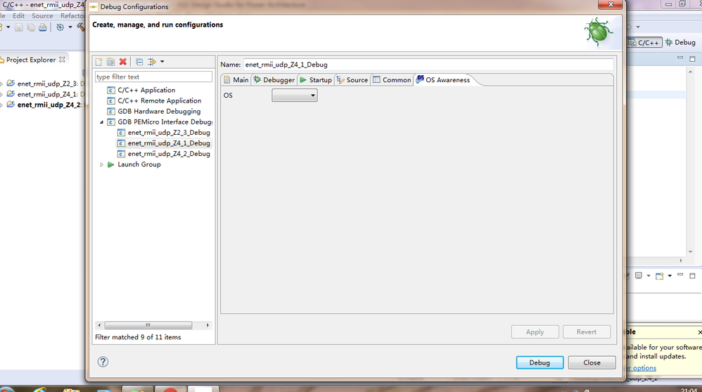

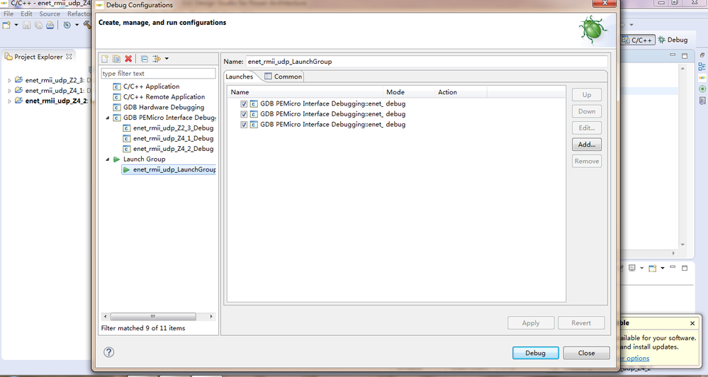

yachuanliu

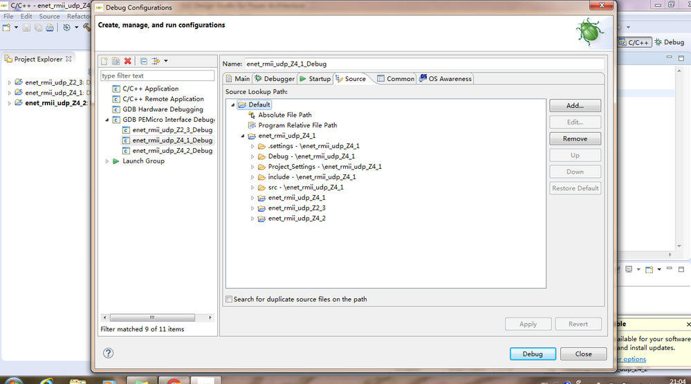

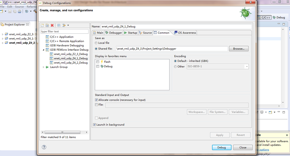

Thank you very much for your help. Here are my debug configurations.
Yachuan

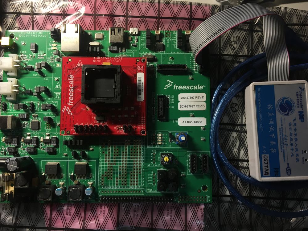

yachuanliu
These are my debug probe and my board. Thank you again for your patience.

martin_kovar
thanks for information. Unfortunately, I do not have this debug probe to try it on my side.

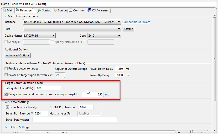

Did you try to load all three projects using LaunchGroup or only the one for z4a core?
Could you please try to add 250ms delay after reset?

martin_kovar
Hello Yachuan,
which debug probe you use? Also, what is the board you use? Do you have Devkit or MPC5748G Evaluation Board?
